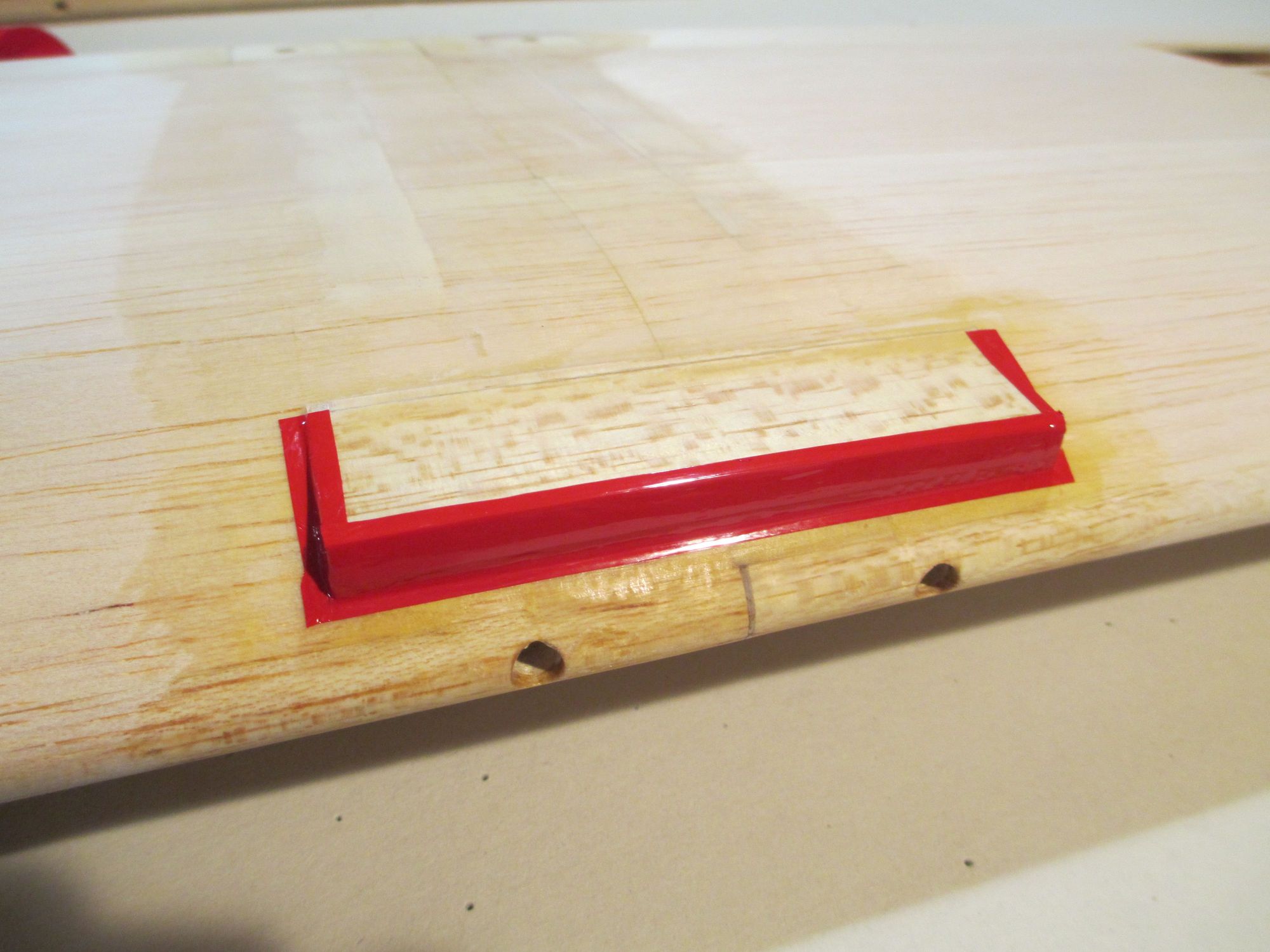

VincentJ June 6, 2019
The first step when covering the wing is to start at the bottom. The overlap from the top of the wing will be more invisible and the air flow will less likely pull your covering off.
